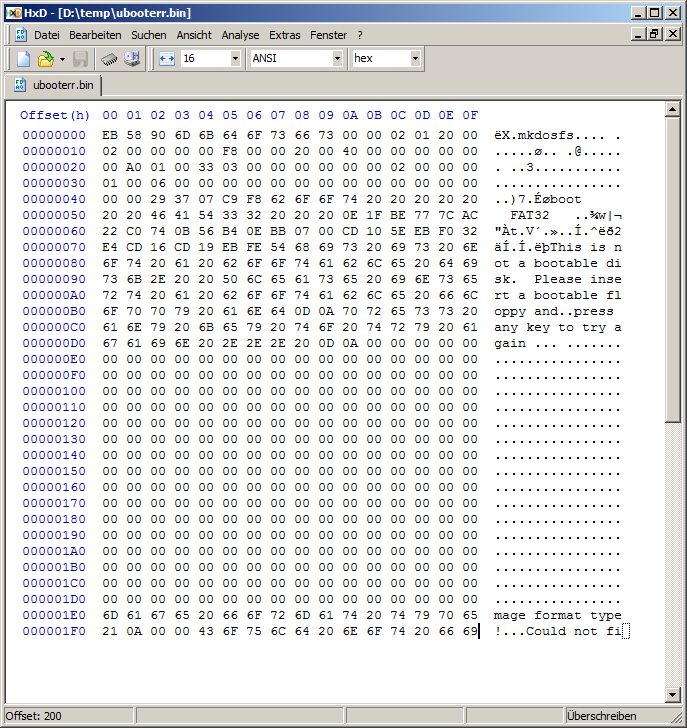

2 The core problem is, that U-boot tries to read the partition info with the function get_partition_info_extended() in part_dos.c and at least the last 32 bytes of the read block is wrong. Usually there are some text fragments (e.g. format strings of printf) from u-boot program.
Example:
I've debugged the problem and the first guess was, that something is going wrong with the data cache from the processor. If I disable the cache (#define CONFIG_SYS_DCACHE_OFF) I can't reproduce the error.
