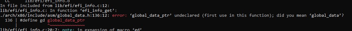

I have a default configuration based on 'efi-x86_payload64_defconfig' (64-bit EFI stub), to which I want to add the EFI_LOADER. In order to do so I also have to enable X86-64 to fulfill the "depends on" criterias in EFI_LOADER Kconfig. I'm doing this by setting X86_RUN_64BIT via the configuration editor.
This dramatically changes the default generated .config file and executing 'make' on top of this leaves me with a number of errors starting with:
[image: image.png]
Trying to resolve it just leads me to another error, and eventually I don't understand what to do.
[image: image.png]

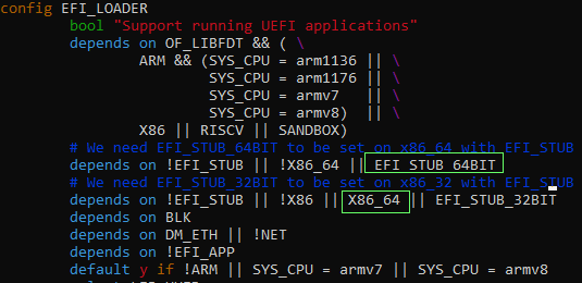

Just to clarify, U-Boot works perfectly fine for me based on either 'efi-x86_payload64_defconfig' or 'efi-x86_app64_defconfig' (but not with the 32-bit equivalents). And with EFI_STUB_64BIT set the EFI_LOADER requires 64-bit mode, but I'm not forced to have 64-bit mode.
[image: image.png]
I'm investigating the UEFI Secure Boot support in U-Boot, and in the end I want to be able to securely boot OS images like for example Linux and VxWorks.

On 4/5/22 10:08, Nicklas Larsson wrote:
My UEFI FW does support secure boot, and I can securely boot a signed U-Boot EFI (based on either 'efi-x86_app64_defconfig' or 'efi-x86_payload64_defconfig').
But I cannot add the UEFI Secure Boot features to my configuration, starting with the CONFIG_EFI_LOADER, when I base my configuration on the configs above.
Can I, and how do I, add the EFI_LOADER to my configuration given the circumstances?
This is not supported yet. Anyhow it would only allow to run 32bit EFI apps loaded by U-Boot as U-Boot will run as i386 binary.
