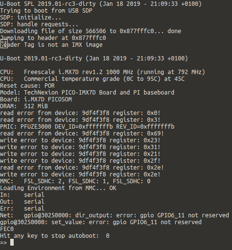

I try to convert Pico-Pi i.MX7D to DM but I'm having some trouble with pmic and ethernet. you can see the log lower
Do you have an idea to solve this?

Maybe you could take a look at Byan's patch that converted imx7s-warp to use PMIC DM: https://patches.linaro.org/patch/156034/
You also need to convert I2C first.
Bryan's complete series can be found here: https://patches.linaro.org/project/u-boot/list/
Hope this helps and looking forward to your patches :-)
