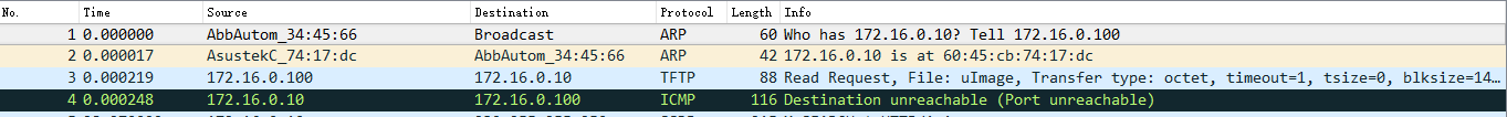

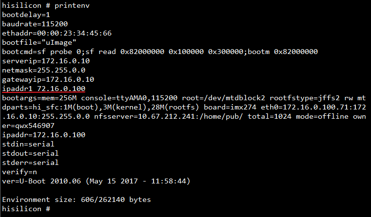

So I used the Wireshark to record what was going on from my desktop, and it showed me that: Destination unreachable (Port unreachable) I thought it was the uImage file missing, but it turned out that it was definitely there: I downloaded the uImage file by chrome browser on ftp://172.16.0.10/ At last, I checked the u-boot configurations and I found a strange thing, as shown below: The configuration item ipaddr1 could be introduced by misspelling, I guess this also happens sometime for everyone here. But strange enough that it could not be deleted, I tried "setenv ipaddr1", "setenv ipaddr1 72.16.0.100", and the item ipaddr1 was still there.
What is the root cause for the failure of ftp operation? does it have something to do with the strange configuration item ipaddr1? Any information or suggestion is highly appreciated.

U-Boot does not have support for TCP/IP, and so it cannot implement the FTP protocol. All we have is TFTP = TRIVIAL FTP.
You your FTP server will not help - you need a TFTP server instead.
This also explains the port mismatch you see in wireshark.

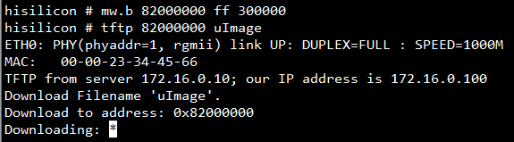

Thank you so much, I managed to upload the kernel image by using a tftp server in my desktop. I thought the tftp was a kind of ftp with a naming difference...
As for the configuration item ipaddr1, I still cannot delete it, I am not happy about that. Do you or anyone else know how to delete this kind of ill-spelled items? If not, I can accept it as it has no side-effect to the system, the uboot brings up the linux kernel every time. However, if there is a way to delete, it would make me happier.
You can run "md" on the memory region which holds the environment, to find out which special characters sneaked in. They you can try to delete the variable by carefully typing the same characters.
Alternatively, you can reset your environment to default and re-add all wanted settings.
