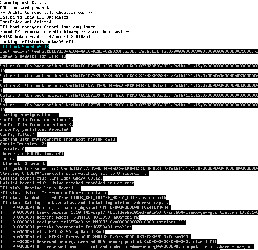

A side effect of this is that the screen will not longer be filled with a new background color, leading to lines that are written with that new background but only for the actual text length. Attached a screenshot to visualize this. Was that intended? Not saying it's necessarily critical.

...strike that: I lost some bits from my "efi_loader: Improve console screen clearing and reset" patch while rebasing, and those were responsible for also setting the background color consistently. Seems I need to work on my own commit message too.
