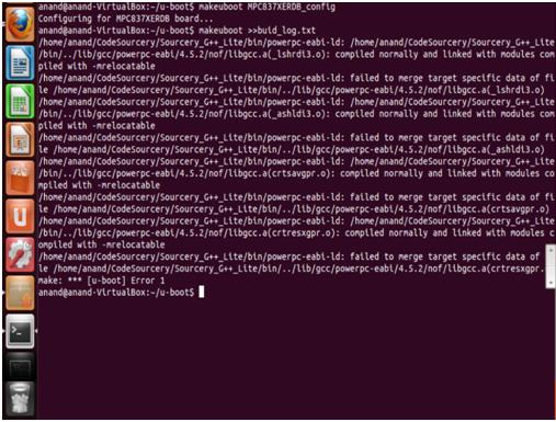

I am Brayan. I was trying to build the u-boot build for the MPC837XERDB board using Sourcery G++ Lite 2011.03-39 on ubuntu. During the build generation, the source code comilation happens fine, but while linking I am getting the error "failed to merge target specific data" for few of the files from libgcc.a
Attached is the error screenshot.
please just cut-n-paste the text next time, it's easier to read.
Appreciate any information regarding this.
it's probably a toolchain issue - try using the ppc_6xx version provided with the ELDK.
