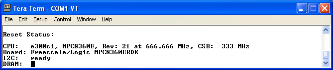

It seems like a pretty trivial update, but it causes U-Boot to hang up at the "DRAM:" line (see below).
you may have to define CONFIG_VERY_BIG_RAM and CONFIG_MAX_MEM_MAPPED.
Kim
