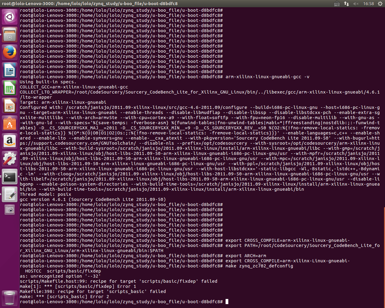

Dear sir : before make , I have do something as below : 1. export CROSS_COMPILE=arm-xilinx-linux-gnueabi- export PATH=/opt/zynq_gcc/arm-xilinx-linux-gnueabi/bin:$PATH 2. export ARCH=arm export CROSS_COMPILE=arm-xilinx-Linux-gnueabi-
3. make zynq_zc702_defconfig

Dear sir : I followed the wiki's steps , the problem have not be resolved ; root@lolo-Lenovo-3000:/home/lolo/lolo/zynq_study/u-boo_file/u-boot-d8bdfc8# make zynq_zc702_defconfig HOSTCC scripts/basic/fixdep as: unrecognized option '--32' scripts/Makefile.host:99: recipe for target 'scripts/basic/fixdep' failed make[1]: *** [scripts/basic/fixdep] Error 1 Makefile:398: recipe for target 'scripts_basic' failed make: *** [scripts_basic] Error 2

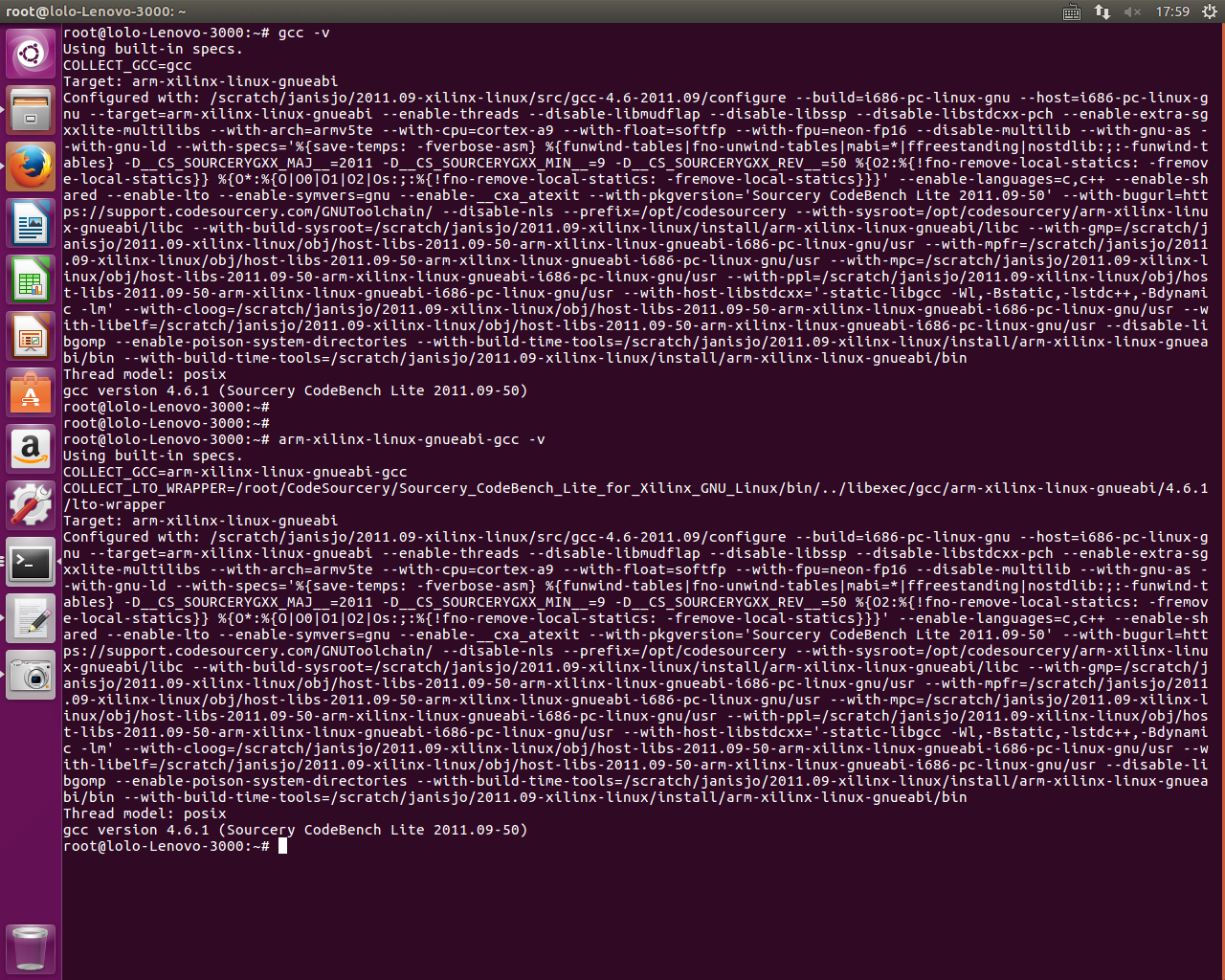

Dear sir: The problem may be as below : use PC linux gcc -v and arm-xilinx-linux-gnueabi-gcc -v , the result are the same ; Do you know how could I to change PC system gcc linkback to x86 compile toolchain ;
