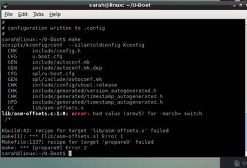

Good Morning, i am trying to compile u-boot on my pc to use it for a ZedBoard from Xilinx. I cloned the repository u-boot-xlnx using this link: https://github.com/Xilinx/u-boot-xlnx.git Made the first make to build the U-boot for a ZedBoard, it works well. Asked for the second make and i received the message that in the file asm-offsets.c:1:0: error: bad value (armv5) for -march=switch I opened the file but couldn't see were was this value
[cid:image001.jpg@01D476BE.1BC339F0]
For information i am trying to compile on a virtual machine using Debian9.5.0
I thank you in advance for your help

It looks to me from the attached image that the error is related to an expected, but missing value for the -march flag. To me, I'd expect to see "-march=ARMv5 switch" instead of "-march= switch". Make note of the empty space in the second.
However I defer to anyone else more knowledgeable on the subject, I'm very new user of the project myself.
Yes you are on the right track.

The problem is more than likely that you are using the host compiler, which is probably x86 and doesn know how to generate output for arm. To compile for an embedded target you need a suitable cross compiler. For debian i believe there is a packaged arm compiler so it should just be a matter of
sudo apt install gcc-arm-linux-gnueabi export CROSS_COMPILE=gcc-arm-linux-gnueabi make ZedBoard_defconfig make
The lastest u-boot does require a fairly up to date gcc for arm. I'm not sure what debian ship. But if you get errors about the cross compiler being too old you might need to grab a more recent compiler from https://www.kernel.org/pub/tools/crosstool/ or the excellent https://toolchains.bootlin.com/
Hi Chris, Ian, i tested with downloading and installing the package through the terminal, changing the CROSS_COMPILE value and redoing the make, it didn#t work. So i tried using the first link https://www.kernel.org/pub/tools/crosstool/ and later https://toolchains.bootlin.com/ but still the same result.
Each time have added the path tot he binary files to my main path (export PATH=‘pwd‘$PATH) and changing the CROSS_COMPILER value according the package i wanted to use but the error stayed the same.
In the end I used the package: armv5-eabi--glibc--stable-2018.02-2.tar.gz2 since the error messages is referring to armv5. Unpacked it into another folder, linked the path tot he binary files and export CROSS_COMPILE=arm-buildroot-linux-gnueabi- But i still got the same error… Do you have another idea? Thank yuo a lot for your help, Sarah
I think to get a better idea of what's going on you should post a complete console log starting from a new shell setting PATH & CROSS_COMPILE up to the build error.
Also just as a test to check your compiler run ${CROSS_COMPILE}cc --version
If it helps here's a recipe that worked for me
wget https://www.kernel.org/pub/tools/crosstool/files/bin/x86_64/7.3.0/x86_64-gcc... tar -xf ~/Downloads/x86_64-gcc-7.3.0-nolibc_arm-linux-gnueabi.tar.xz git clone https://github.com/Xilinx/u-boot-xlnx.git cd u-boot-xlnx export PATH="$HOME/gcc-7.3.0-nolibc/arm-linux-gnueabi/bin:$PATH" export CROSS_COMPILE=arm-linux-gnueabi- make zynq_zed_defconfig make
