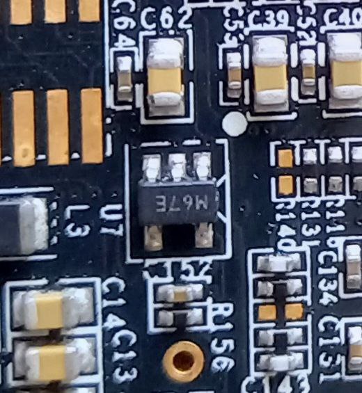

Hi Robert,
I have BBB from different vendors, and I do remember that I've purchased the Element14 version at some point. However, I've messed everything up and cannot figure out which board from which vendor. You are the most probably right, but still I cannot confirm the origin.
Can you please take a quick snapshot of the eeprom, it should be... 24LC32AT-I/OT but maybe they used another variation..
Attached here is U7. It says M67E. 24AA32A/24LC32A datasheet page 14 says that it should be 24LC32AI.
Regards,

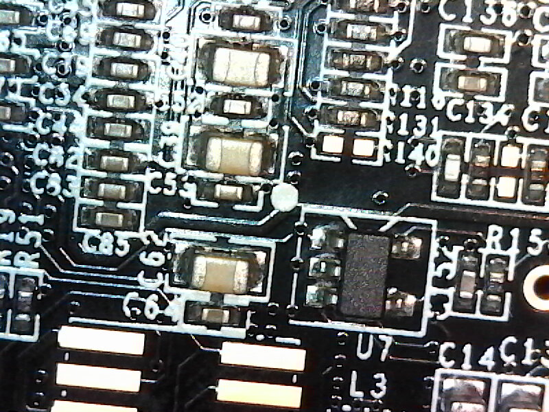

Wierd.. took me a bit of digging, but I did get the element14 beaglebone rev C black board as well.. but it boots fine for me.
https://gist.github.com/nmenon/104f040a67a6af0b0418c95ad83ad50b
I tested the very tip of master: 3dd4e916324e Merge https://source.denx.de/u-boot/custodians/u-boot-marvell
Seemed to boot fine. Apparently it is supposed to be the same type as your board as well and it boots just fine on master.
U7, however, on my board, is unmarked.
Not really sure what to make of this.
