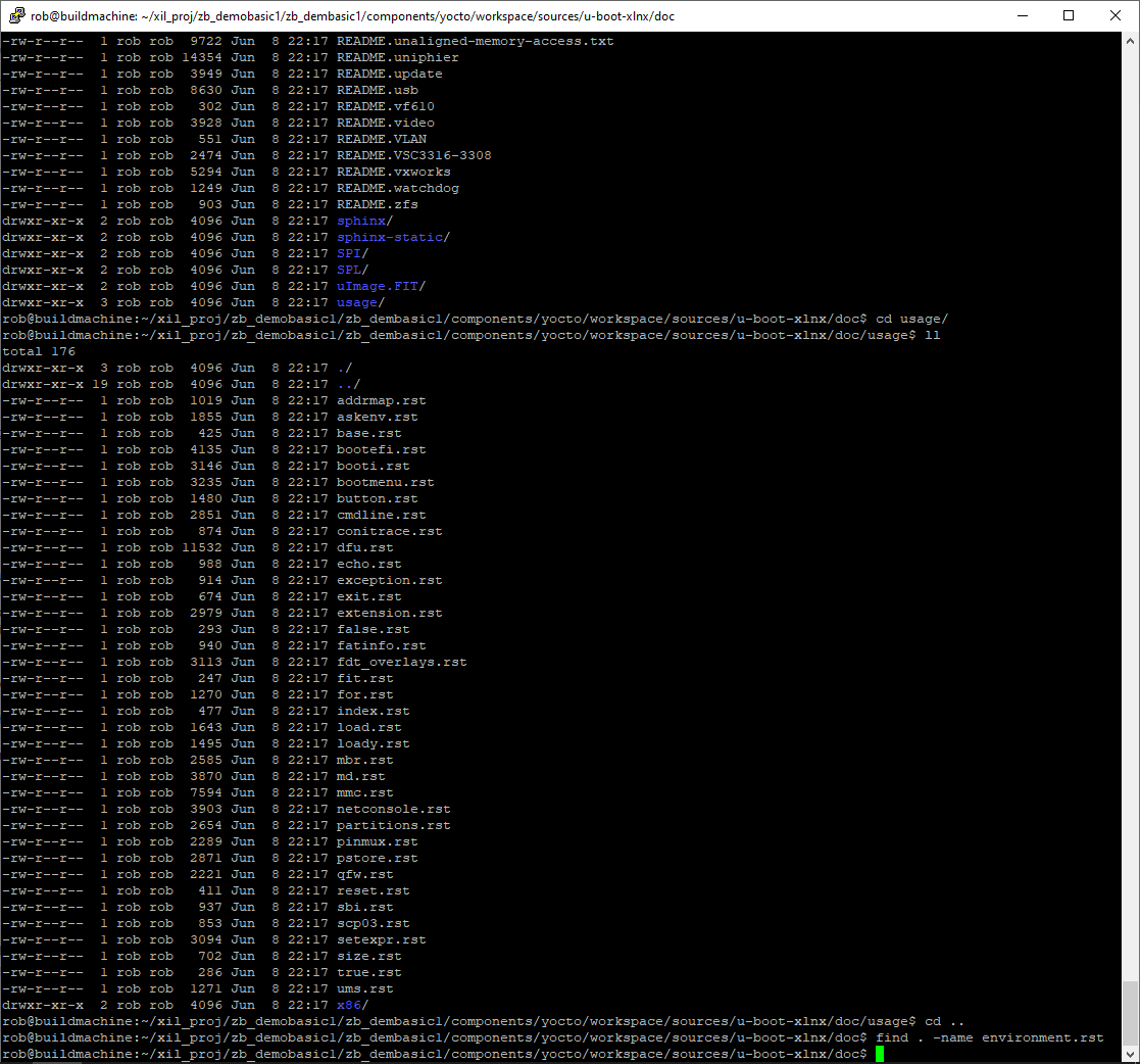

I also couldn't find the environment.rst in my docs - took a screenshot below. As an aside I'm using a Xilinx version of u-boot from the following repo.
https://github.com/Xilinx/u-boot-xlnx
[image: image.png]
