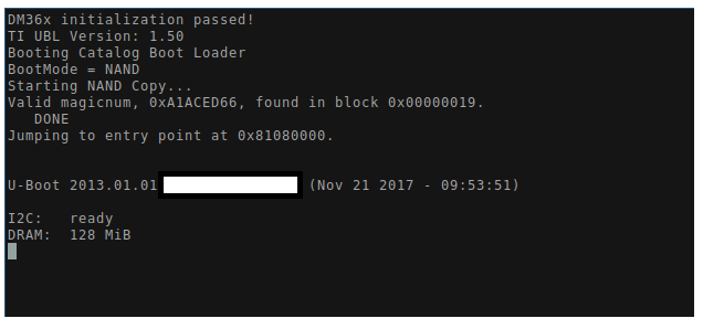

Hi Simon, I got what is the 'dm tree' which is a driver model. This command could be done only in uboot stage. but i got the situation in which the initialisation of u-boot has not finished yet as showing in the following picture.
[image: image.png] .i would like to know what is wrong in the initialisation ?
Best Regard, Aubin

Hi Aubin,
Please try to avoid top posting.
I think the best thing is to move to the latest U-Boot. You are about 9 years behind! But as to your question, I am really not sure. If it is a TI board, you could try asking them?
Regards, Simon
