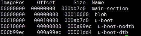

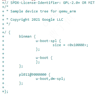

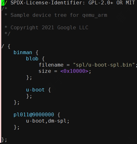

2. Baseed on this patch, we have made the following modifications: a. arch/arm/dts/qemu-arm-u-boot.dtsi (Left is original, right is modified, we think they are actually the same) 3. After compiling, image.bin is generated, image.map is as follows(we think it's ok, spl base addr is 0x00000000, and u-boot base addr is 0x00010000):
- but when we use following command to execute, it will block.
command: ./qemu-system-arm -machine virt -nographic -bios image.bin result: 5. some key files size: image.bin: 767936 u-boot.bin:694764 u-boot-spl.bin:15112
