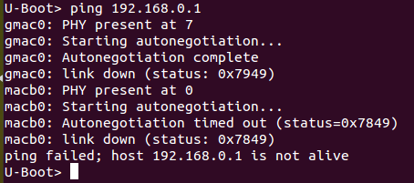

I have connected the board with my laptop directly, When I run PING command following message occur,
U-Boot> ping 192.168.0.1
gmac0: PHY present at 7 gmac0: Starting autonegotiation... gmac0: Autonegotiation complete gmac0: link down (status: 0x7949) macb0: PHY present at 0 macb0: Starting autonegotiation... macb0: Autonegotiation timed out (status=0x7849) macb0: link down (status: 0x7849) ping failed; host 192.168.0.1 is not alive

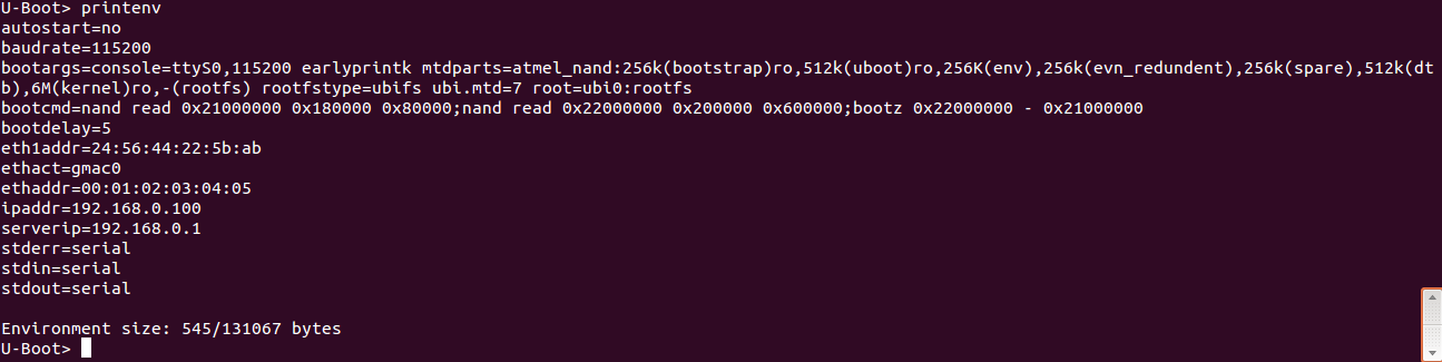

this output comes for print environment after setting all the address for server and client.
U-Boot> printenv
autostart=no baudrate=115200 bootargs=console=ttyS0,115200 earlyprintk mtdparts=atmel_nand:256k(bootstrap)ro,512k(uboot)ro,256K(env),256k(evn_redundent),256k(spare),512k(dtb),6M(kernel)ro,-(rootfs) rootfstype=ubifs ubi.mtd=7 root=ubi0:rootfs bootcmd=nand read 0x21000000 0x180000 0x80000;nand read 0x22000000 0x200000 0x600000;bootz 0x22000000 - 0x21000000 bootdelay=5 eth1addr=24:56:44:22:5b:ab ethact=gmac0 ethaddr=00:01:02:03:04:05 ipaddr=192.168.0.100 serverip=192.168.0.1 stderr=serial stdin=serial stdout=serial
