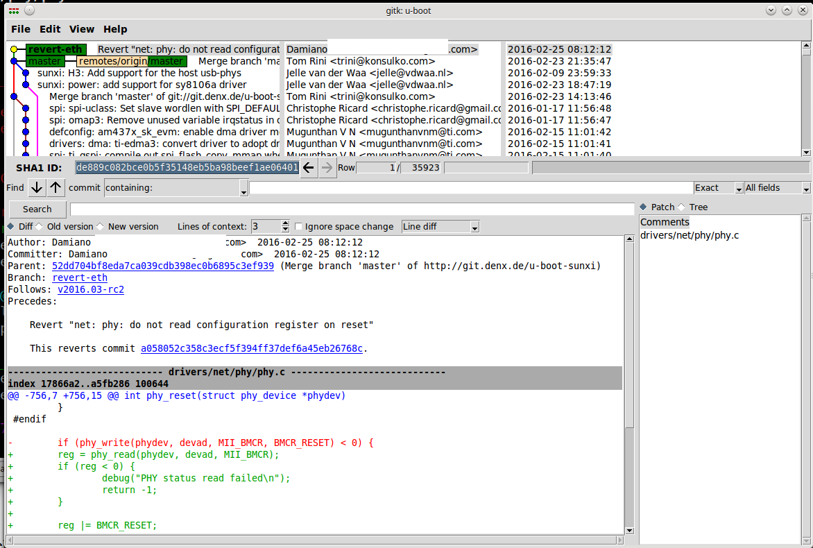

Good morning Peng
I did revert the commit, see attached image showing git repository status
Unfortunately the result is still negative, see the following log
U-Boot 2016.03-rc2-00117-gde889c0 (Feb 25 2016 - 08:12:50 +0100) Allwinner Technology CPU: Allwinner A20 (SUN7I) I2C: ready DRAM: 1 GiB MMC: SUNXI SD/MMC: 0, SUNXI SD/MMC: 1 In: serial Out: serial Err: serial SCSI: SUNXI SCSI INIT SATA link 0 timeout. AHCI 0001.0100 32 slots 1 ports 3 Gbps 0x1 impl SATA mode flags: ncq stag pm led clo only pmp pio slum part ccc apst Net: eth0: ethernet@01c50000 starting USB... USB0: USB EHCI 1.00 USB1: USB OHCI 1.0 USB2: USB EHCI 0.00 USB3: USB OHCI 0.0 scanning bus 0 for devices... 1 USB Device(s) found scanning bus 2 for devices... 1 USB Device(s) found Hit any key to stop autoboot: 0 ethernet@01c50000 Waiting for PHY auto negotiation to complete......... TIMEOUT ! ethernet@01c50000: No link. ethernet@01c50000 Waiting for PHY auto negotiation to complete......... TIMEOUT ! ethernet@01c50000: No link. Bad Linux ARM zImage magic!

Good morning Peng, I cannot attache an image, moderators will stop it forever
