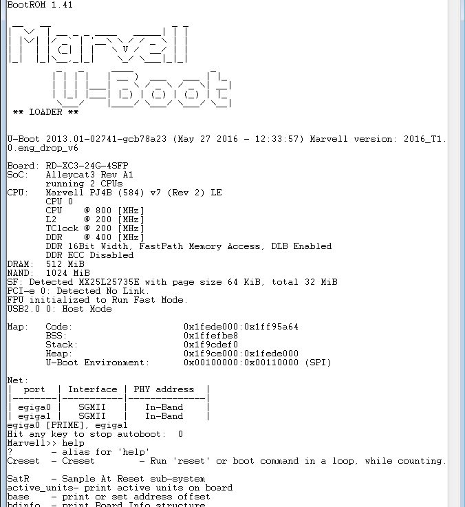

I am developing firmware for a Marvell Ethernet switch chip (98DX3336) on the RD-XC3-24G4XG-B (Marvell Ethernet switch). Marvell has provided me with U-boot binary files for UART, SPI etc. I managed to load the U-boot UART binary file trough the UART interface. Showing:
[cid:image003.png@01D3E22C.D21A6560]

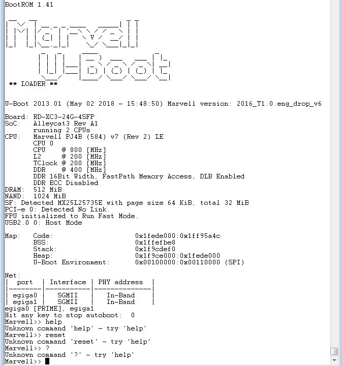

Ok so that is good... now I need to set up my own u-boot environment to add some changes. So I did. I Downloaded u-boot 2013.01 and added marvell configurations. I was able to compile and load the U-boot Uart binary trough the UART interface. The terminal is showing the following:
[cid:image004.png@01D3E22D.C73E7040]

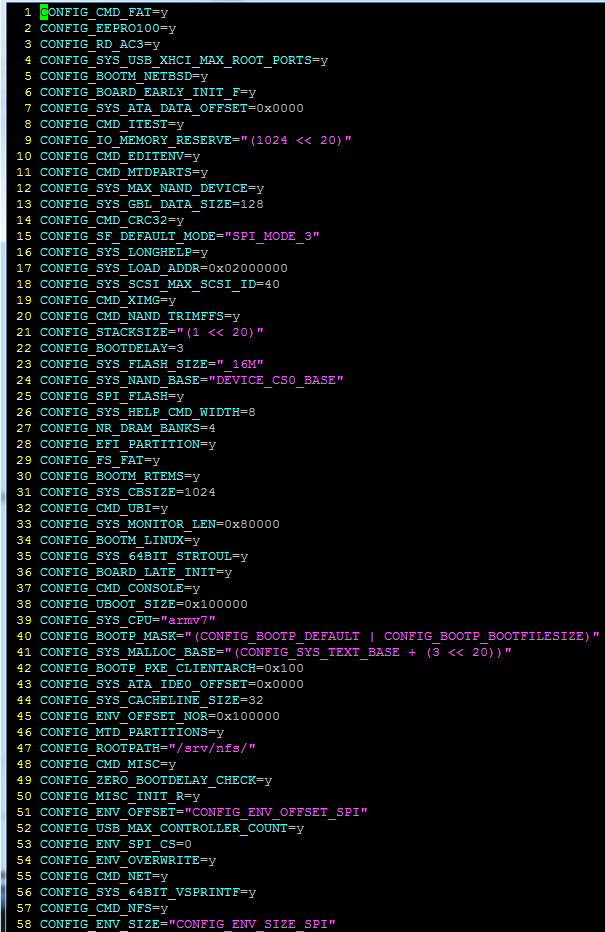

So ok its loads! But now... I can not perform any commands. All commands are Unknown... So what I did was checking the configurations and I found out that I have set the CMD configurations. Like CMD_NET etc etc
[cid:image005.png@01D3E22E.7D8A6070]
Anny one that could help me here? I would really appreciate it. I am struggling with this problem for almost 2 full days now. Actions I have been taken

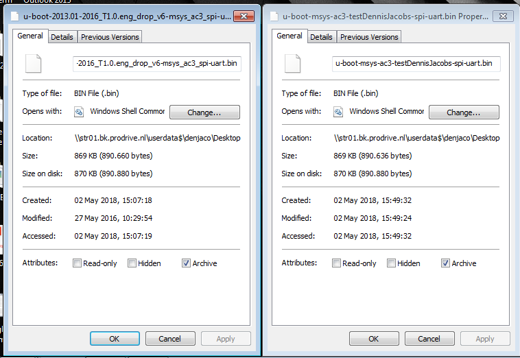

Left binary is the working one the second binary is mine. It only differs 26 bytes. I noticed that a different cross compiler also changes the size. Sometime more sometimes less. All of the binarys I compiled where executing correctly but not reacting on anny commands
Showing:
are Unknown...

I think it is actually this.
Are you using hyperterm by any chance? I hit a problem a while back where hyperterm worked fine for a while but then started adding other invisible characters to my input which in-turn caused every command to be rejected. Particularly if I'd used the uart boot. My primary environment is Linux so I'm not sure what people are using for a terminal emulator on Windows these days. When I last used a windows box for work teraterm https://ttssh2.osdn.jp/index.html.en was the terminal emulator we used.
The uart tx/rx lines on the RD-XC3 board don't appear to be well controlled, there always seems to be a bit of junk captured around reset due to the lines floating. So even if it's not your terminal emulator getting confused your host UART driver might be.
The fact that you've proven your built image boots over uart means the spi version should work. So I'd recommend just updating what's on the board (make sure you feed it the spi.bin not the spi-uart.bin). If it all goes catastrophically wrong you can still recover the system over uart.
