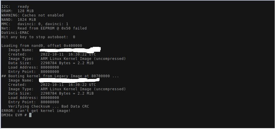

Hello Simon,
My board boots well . When I added the second partition into my kernel I got this message *Verifying Checksum ... Bad Data CRC* what could be the root cause ?
Which data is talking about ? u boot data or kernel data ?
Thanks in advance.

Thanks Fabio and Simon,
find attached the log picture. When I changed the size of the one partition in the kernel, I got this message. Does the calculation of CRC in uboot depended on the size ?
[image: image.png]
Thanks, Aubin
It seems like your kernel is corrupt and the crc is failing. Yes the crc is calculated based on the full size of the kernel data as shown.
- Simon
